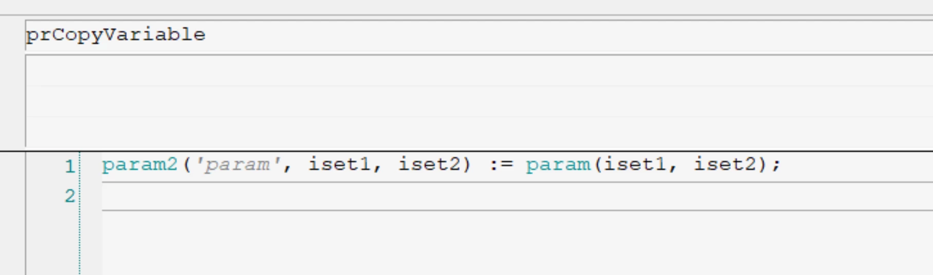

My procedure uses the AIMMS model edit functions to create a procedure dynamically that will have a body based on the assignment of all elements from subset1 to param2.
You can even see the generated code after you run it:
Which is what I imagine you want.

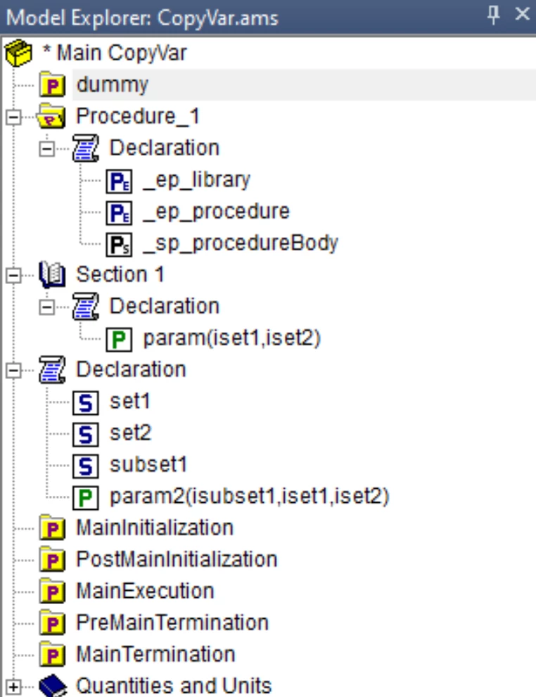

And I had to add a dummy procedure that does nothing in order to use apply:
Procedure dummy;
This is what my explorer looks like:
