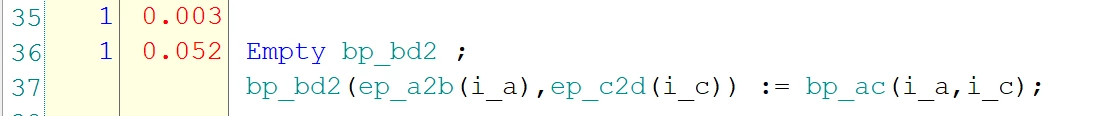

Efficient approach — inverse element parameters on the LHS:
Running indices are [i_a, i_c] — the indices of the source data. The engine makes a single pass over the non-zero elements of bp_ac, converting each index before storing.
The above screen shots confirm theory.

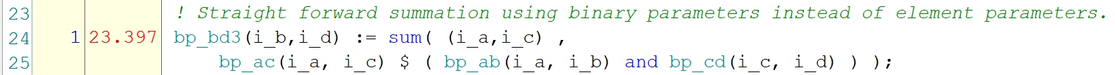

First attempt — naive reformulation using binary parameters:
The index order here is [i_b, i_d, i_a, i_c]. Starting from [i_b, i_d], no identifier constrains the valid values of i_d for a given i_b, so every i_d is tried for every i_b. Even though each probe is cheap, the total is O(card(s_B) × card(s_D)) operations.

Concern 2: what if bp_bd2 already has data?
This one can come as an unwelcome surprise.
If bp_bd2 already contains data and you execute the assignment a second time:
When a parameter already has data, the execution engine must ensure that any zero computed on the RHS results in a deletion on the LHS. Because the LHS uses element parameters (not plain indices), this is not a straightforward pass over existing data — additional work is required to locate and remove stale values.
The remedy is simple: empty bp_bd2 before the assignment:
Adding an empty statement resets the parameter first, so the subsequent assignment runs as efficiently as the first time.
