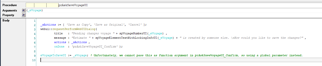

I’m using the webui::requestPerformWebUIDialog a lot, for example for saving specific voyages. I would like to be able to add extra input arguments to the onDone procedure, such that I don’t need messy global parameters for that. Also there is a risk that other developers call the onDone procedure directly without initializing eVoyageToSaveUI properly. Also see example below.
Can you add support for an extra (string) input argument for the onDone procedure, for example by adding a onDoneArgument to the arguments of webui::requestPerformWebUIDialog?
