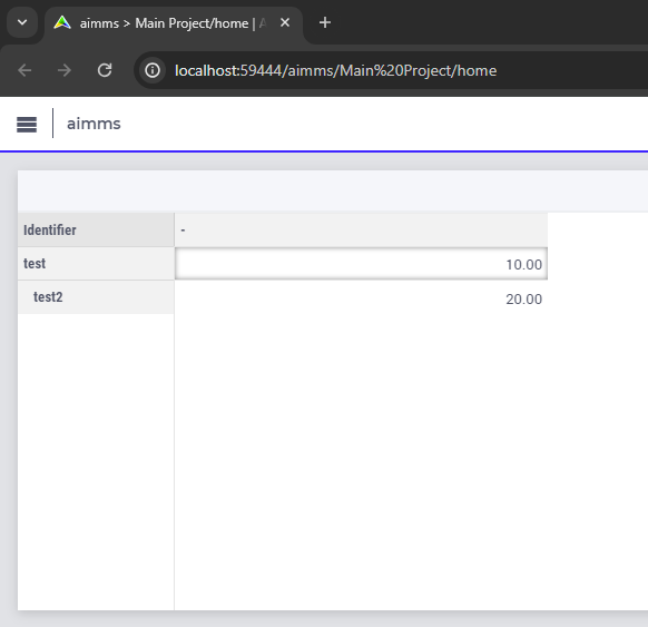

And the screenshot of the application:
So, basically, you need to add a   for whitespaces.
