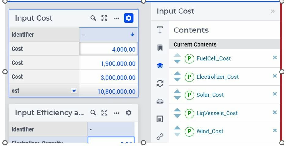

See Image 1) When creating the table “Input Cost” the identifier names on the first column are not the same as in the parameters. How can I adjust them? I also want to change to zero decimals but cannot find how to do so.

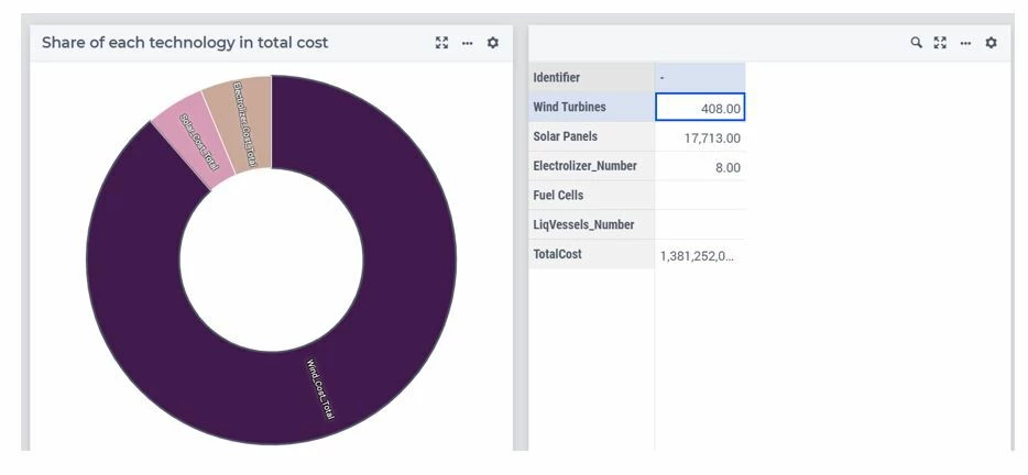

See Image 2) How can I add units ($) to this chart and table? I tried creating a Quantity Identifier in AIMMS (backend), but then I cannot add it to the parameters nor to the chart.

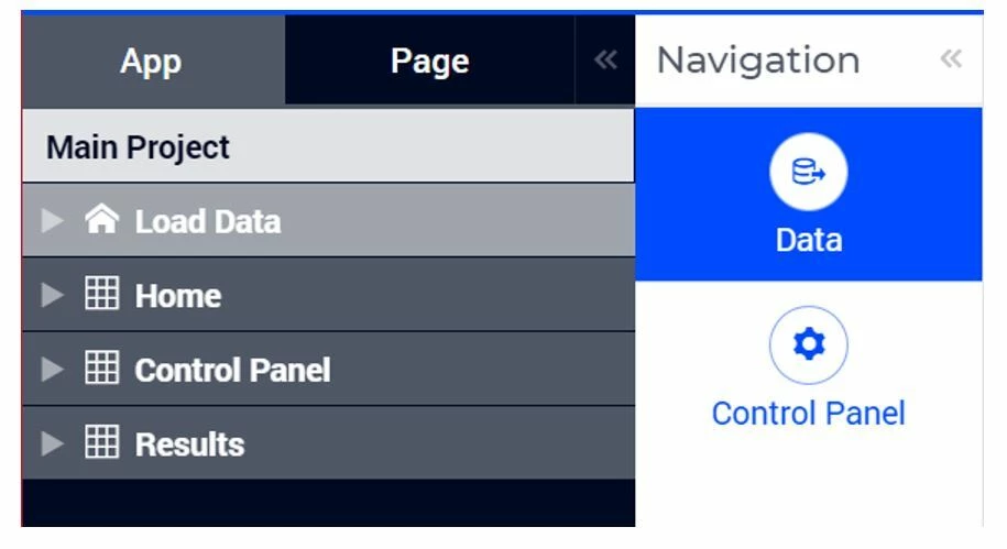

See Image 3) How can I add the “Results” page to the Navigation?
You probably already have a .properties file under your project, you need to go under Main Project > WebUI > resourses and find the file. Once you found it, open search by the AIMMS identifiers you want to rename. Read more here: https://documentation.aimms.com/webui/webui/multi-language.html#project-specific-translations.
For the pie chart, the units are already there, if you hover the slices, you should see the percentage number and the unit. For the table, you can show units activating this setting:
You are using Workflow for the project navigation, to add a new page, you need to find the string parameter that holds your workflow settings and add it there. Read more here: https://documentation.aimms.com/webui/webui/workflow-panels.html#workflow-panels.
