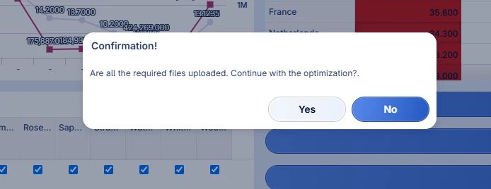

Very often I want to give an explicit confirmation dialog (e.g. when deleting items).
I can implement that with creating my own dialog page in the webui, but these are typically quite large for the intended purpose (custom size with 1 row, 1 col).
When you try to delete a page in the webui in aimms itself, it gives also a confirmation dialog page:
I was wondering, is there an easy way that I can access a similar type of simple dialog message from within my own applications?
Best answer by Madhu Krishnappa
Hi ​@gdiepen,
You can try using webui::RequestPerformWebUIDialog() to display a smaller confirmation dialog, like the one shown below.
For example, I triggered a procedure with the following content to get the dialog shown in the screenshot:
ButtonsOnDialog := data {'Yes', 'No'};
webui::RequestPerformWebUIDialog("Confirmation!", "Are all the required files uploaded. Continue with the optimization?.", ButtonsOnDialog, 'OnDoneProc');
Curious to hear if this helps.

Madhu Krishnappa
Hi ​@gdiepen,
Thanks,
Madhu Krishnappa
gdiepen
AIMMS Champ
Forum|alt.badge.img+7
  • Author
  • AIMMS Champ
  • Sep 7, 2026 6:45 AM UTC
This was indeed the one I was looking for, thanks!
