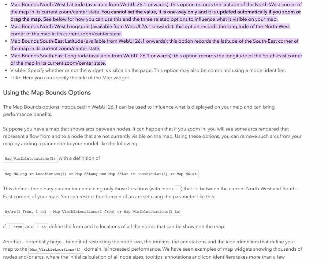

I hope you’ve been following the AIMMS WebUI release notes. Earlier in 2026, we worked on this feature request and extended the Map widget to report the current North-West and South-East coordinates of the visible map area.
This should provide the corner coordinates you were looking for when an action is triggered, such as by pressing a button.
You can find more details in the WebUI release notes.
Here is a note from the Map widget documentation.
